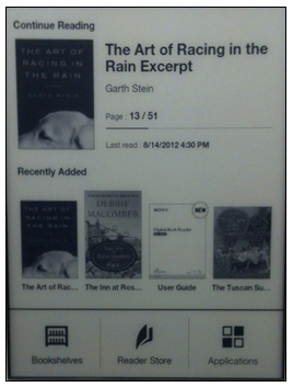

- While the screen displays opening book....., simultaneously press and hold down the Page Turn (Next) and Back buttons.
- Allow the Home screen to fully load (Loading... should no longer flash in the top left corner of your screen) and then follow the sequence below while still holding down the Page Turn (Next) and Back buttons:
