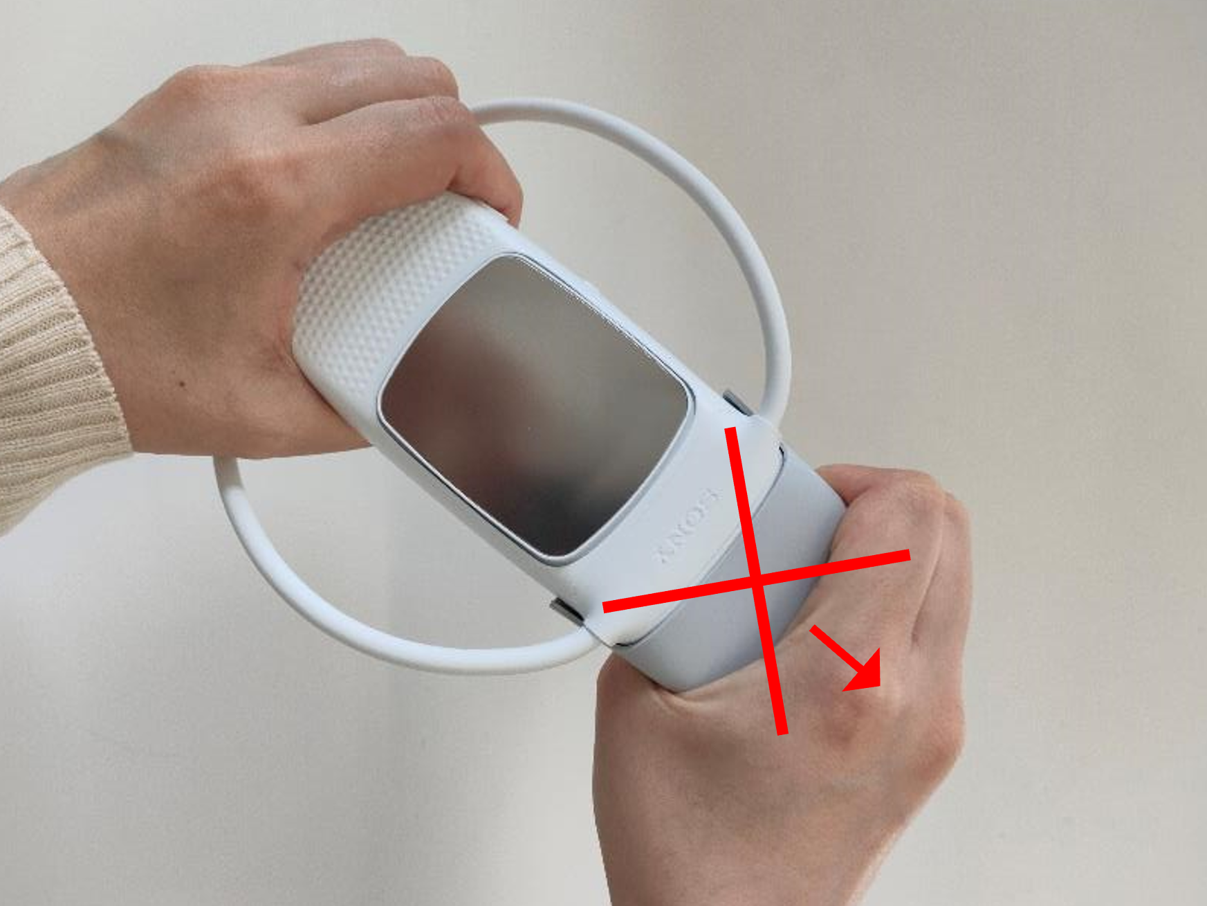

    IMPORTANT: When removing the air vent cover, do not pull the cover off the neckband as shown in the photo below.

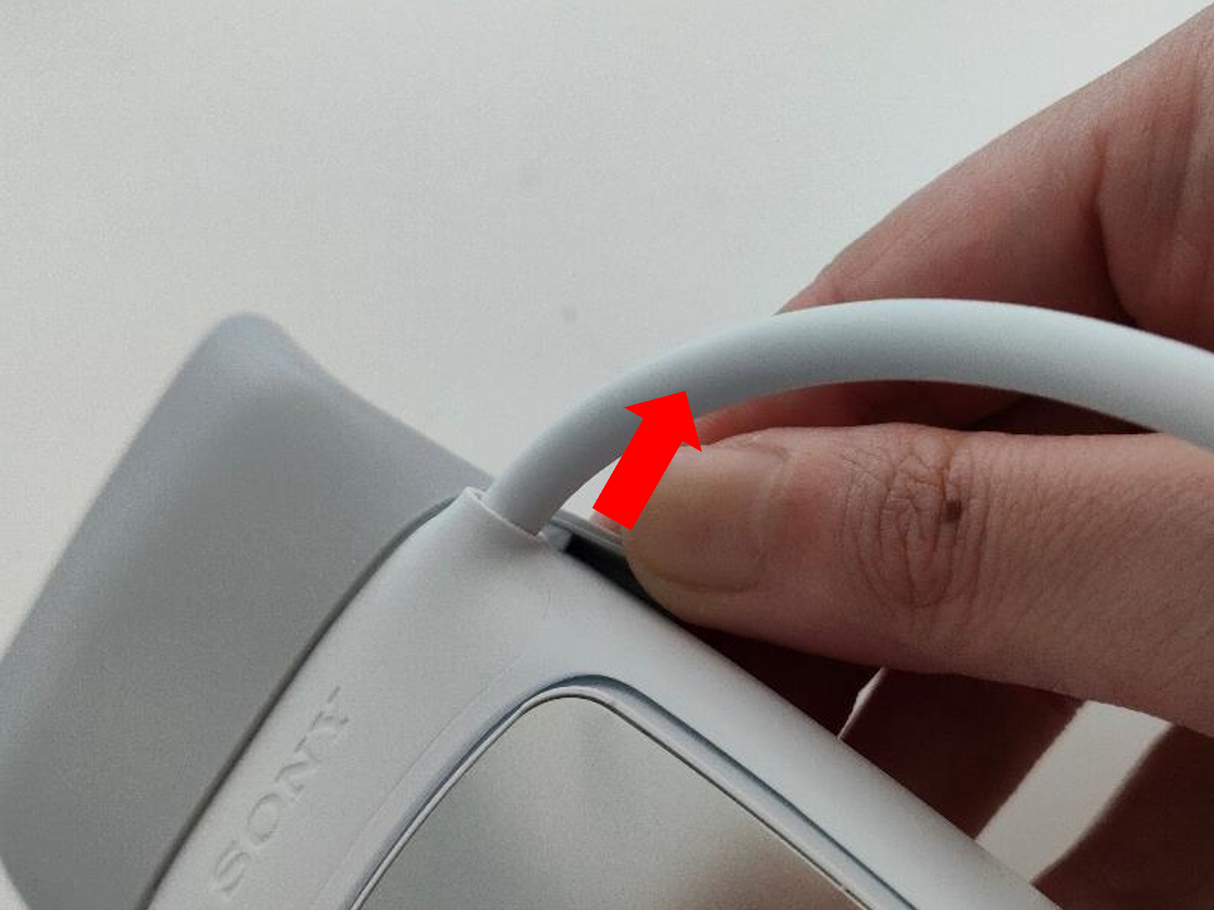

    You should remove the air vent cover by moving the tab following the direction of the arrow as shown in the photo below.
    Note: The air vent cover is attached to the hole1 in the neckband using tabs2 . This is to prevent the air vent cover from coming off easily due to contact with your clothes or body.
