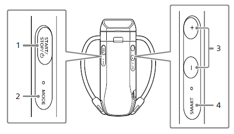

    For RNP-P1 (REON PRO)
    You can perform cooling / warming operations by using the following buttons on the unit.
    To use all functions, you will need to connect with your smartphone.
    reonpro
    1. START / STOP / (power) button
      Starts/stops operation. Pressing and holding the button for about 2 seconds turns the unit on/off
    2. MODE button
      Switches between COOL (cooling operation) and WARM (warming operation).
    3. + (plus) button / - (minus) button
      Switches to the MANUAL COOL/MANUAL WARM mode. You can adjust your desired cooling/warming intensity
    4. SMART button
      Switches to the SMART COOL/SMARTWARM mode. The unit automatically adjusts the cooling/warming intensity based on the environment and your desired settings.
