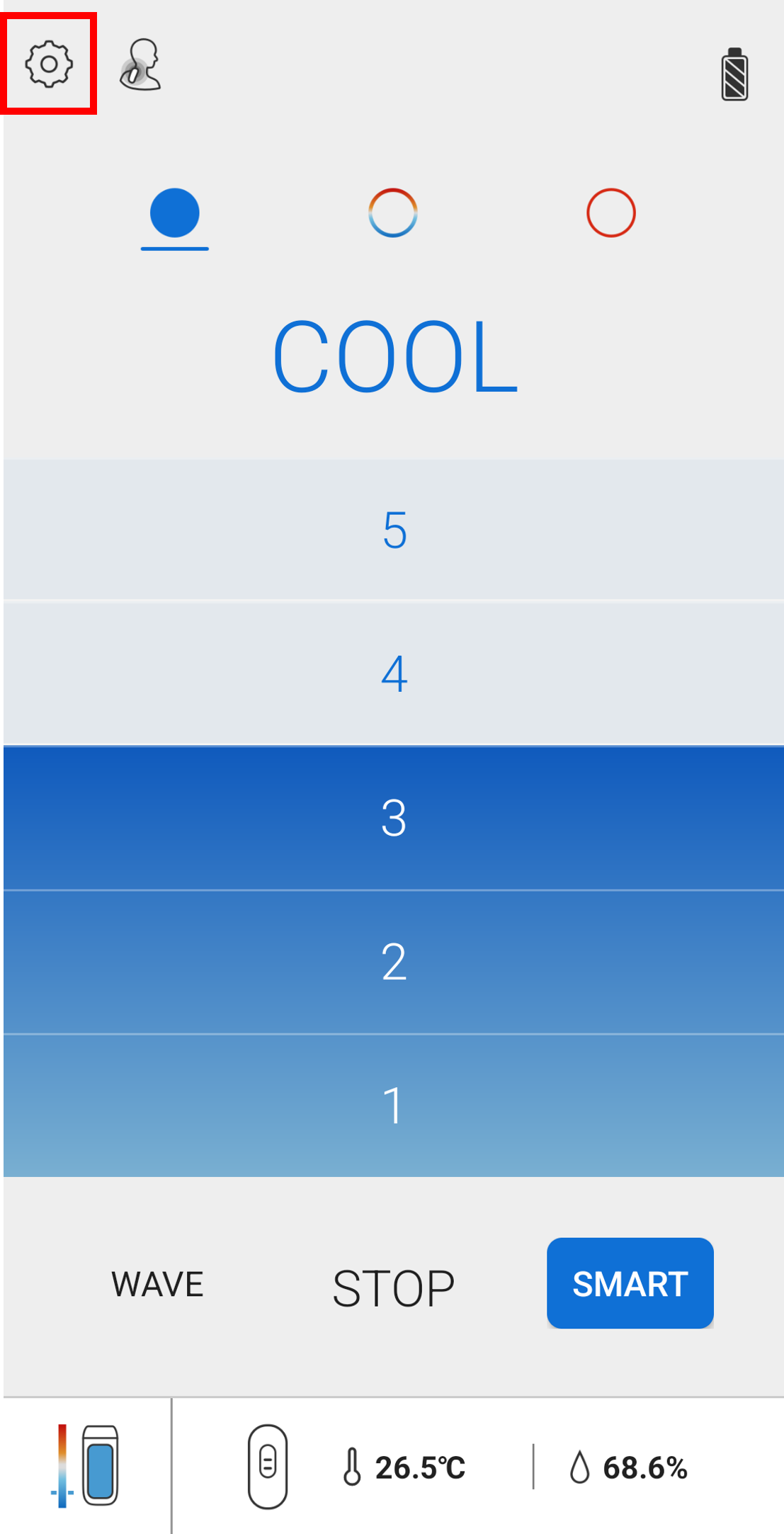

Check the firmware version
You can check the firmware version as follows.
  1. Launch the REON POCKET app.
  2. Connect your REON POCKET to the REON POCKET app.
  3. Tap the settings button in the upper left corner.
  4. The current firmware version of your device can be found under "Device Software Version"
