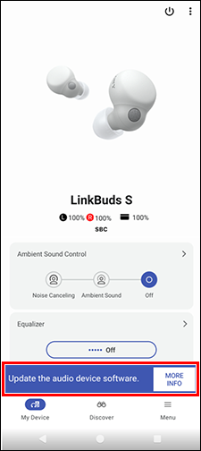

    Note: When the Automatic download of software setting is enabled (factory default setting) on the Sony | Sound Connect app, the download and transfer of the update software is started automatically. If you have disabled the Automatic download of software setting on the Sony | Sound Connect app, the download and transfer of the update software will not start automatically and you will need to follow the procedure below:
    1. Make sure both the R and L sides of the headset are connected.
    2. The following screen will be shown when the connection has been established. If an update is applicable, the message “The latest audio device software is available” will be displayed and you can press MORE INFO.
      The message and [MORE INFO] button will be displayed at the bottom of the screen.
    3. Move to the Update Software screen. Verify that Version 4.3.1 is displayed and press START (for Android device) or Start (for iPhone).
  4. “Update the audio device software” will be displayed and you can press MORE INFO.

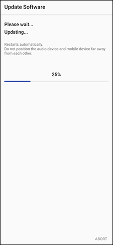

  6. The update process will start and take a few minutes to complete.
    Note: During the update, the headset will turn off automatically. They will turn back on and reconnect via Bluetooth before the update is completed.
  7. When the software update is completed, press OK.
