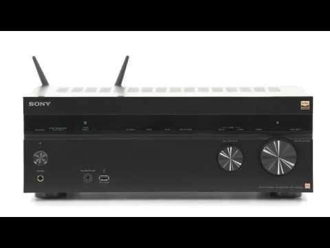

[VIDEO] PROTECT or PROTECTOR is flashing in the display of the home audio device.
    Refer to the video below for how to remove "Protect Error" on a Sony receiver.

    If the words PROTECT / PROTECTOR and PUSH POWER appear in alternating sequence on the display of your home audio device, or if the words PROTECT or PROTECTOR appear, there may be an external speaker issue or connection issue that is triggering the protection circuit. Try following these steps to resolve this issue:
