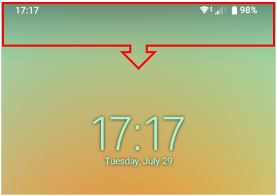

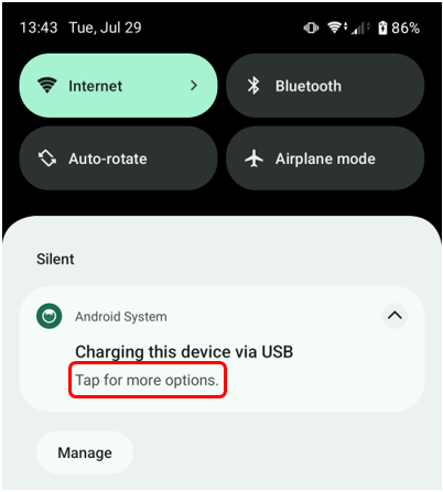

- Make sure your phone screen is unlocked, and that the USB connection mode on your phone is set to File Transfer (or Transfer files). The default connection mode is No data transfer (Charging only). For a computer to detect your phone, select the USB connection mode every time you connect your phone to a computer.
